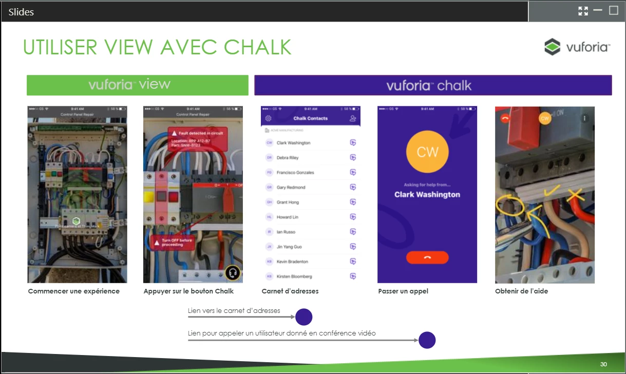

This request is not really coming from a customer in terms of "usecase", two weeks ago, I did a demonstration on Vuforia Studio and on Chalk, this demo has been well appreciated by the customer, and I had a lot of questions during this demo, particulary on "how to contact an expert ?"
During viewing an experience (Maintenance usescase) if I misunderstand something, something is missing to understand the details, how can I contact an expert ? (To have a audio & video conversation)
it seemed obvious for me to use "Chalk" and by consequence, to be able to launch "chalk" from an experience.
What can be the differnts steps?
1-Launching a Vuforia experience
2-In case of needs, have an access  to "Chalk" through Button
3-Access to "Chalk"'s address book
4-Select an Expert
5-Open a connection
To be honest with you, the integration of the two products, seems to me to be an interesting business opportunity.

July 18, 2018
Snapshot from the PTC Webcast.
This can help you to understand.
Lionel
