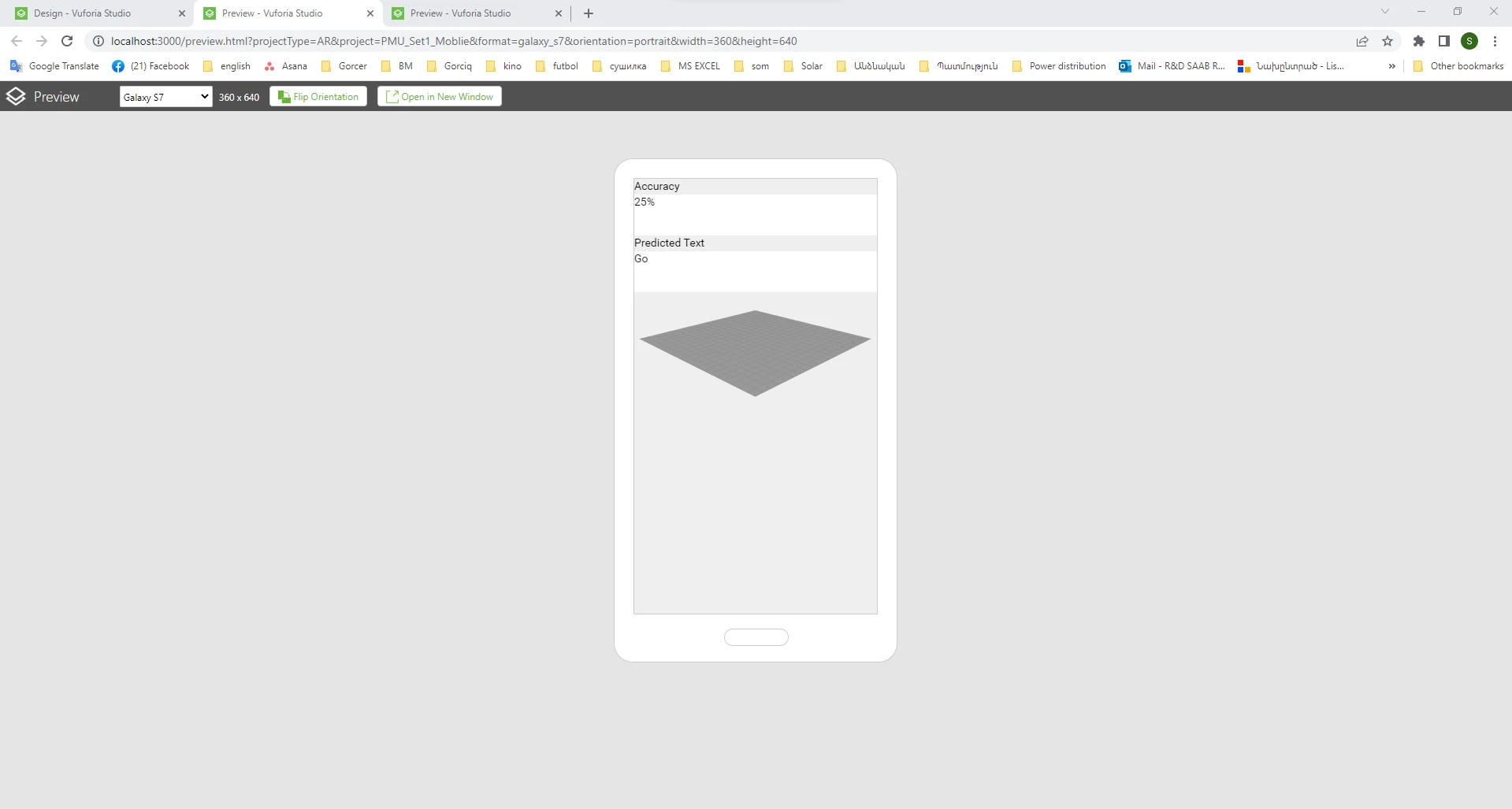

I created a Vuforia Studio project with couple of widgets(text area). I bind them to ThingWorx tags.

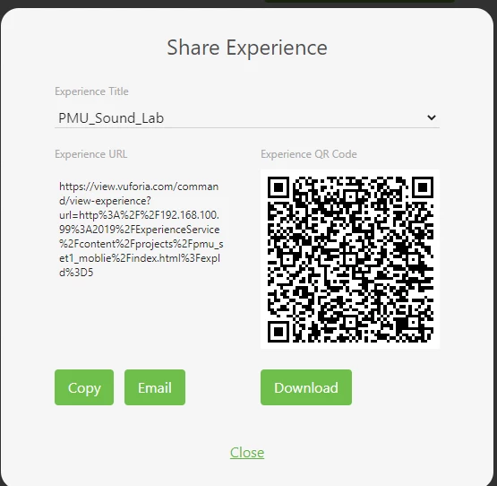

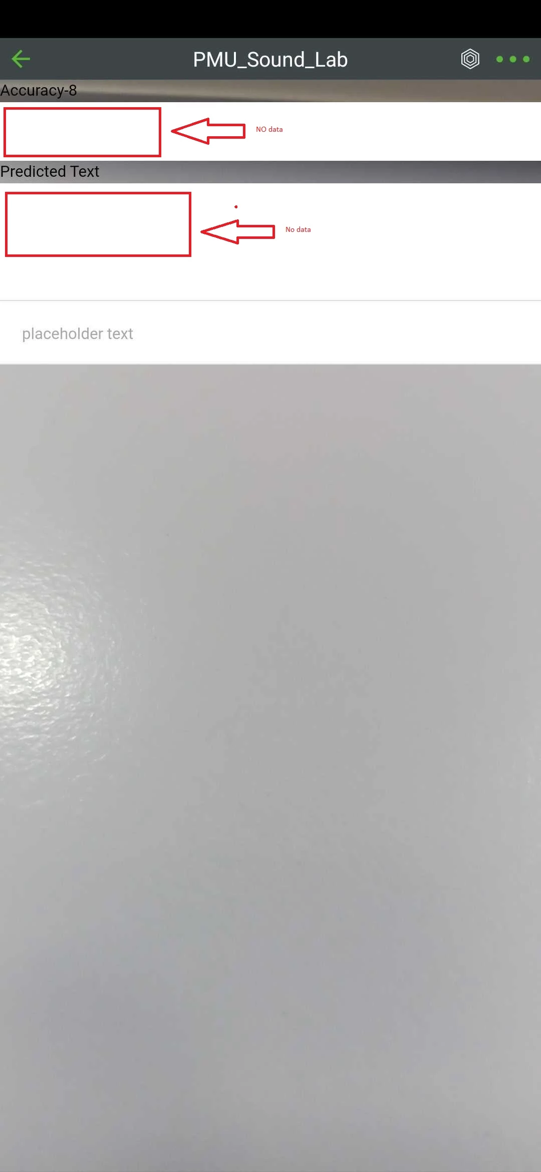

When I do a preview I can see the data updating on the text areas. But when I Publish and Share it and then scan the QR code from the Vuforia view in my smartphone, the data on the text areas do not show up. Could you please help me understand what is the issue and how can we solve it.

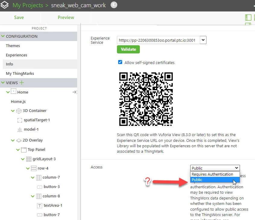

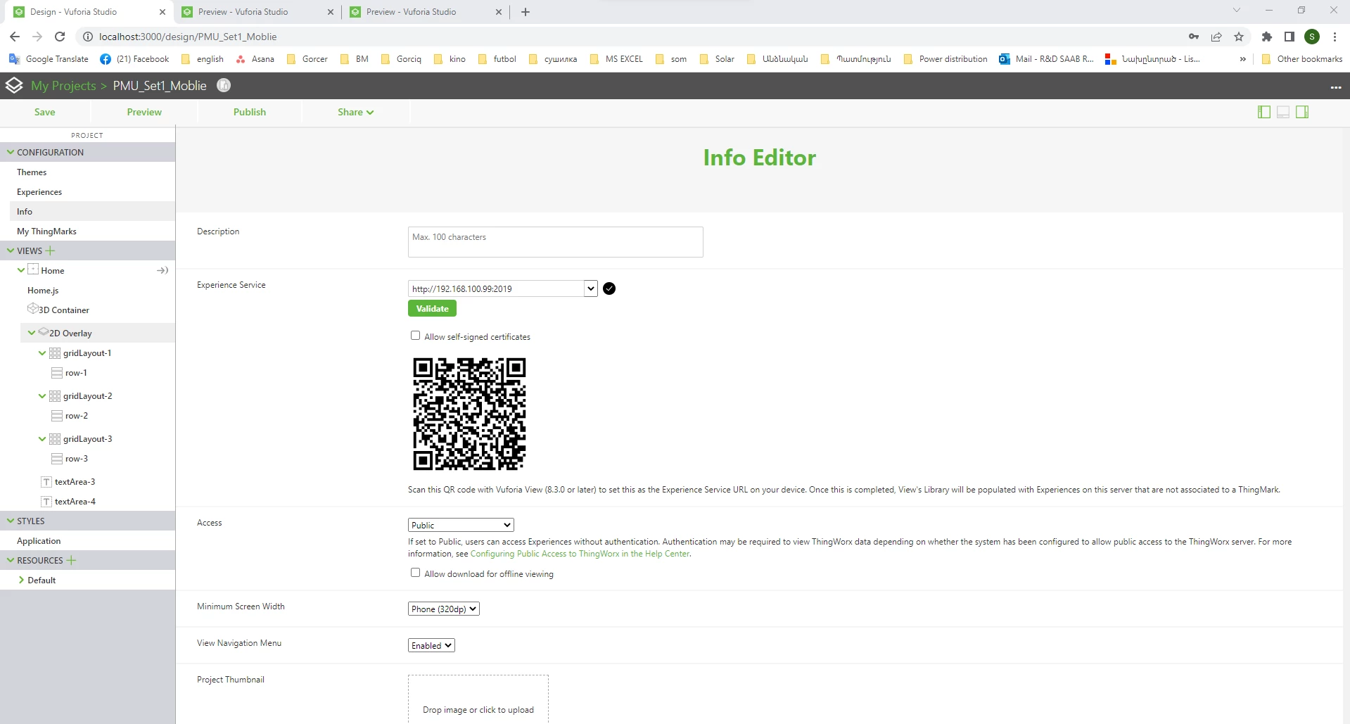

Regarding to this issue I need Info about the access status of your Project.  Is this Studio project published with  PUBLIC access. You can check this in the Info Project Tab:
Depending on this settings – issue could be based of the security settings for your property and the es-public-access/ es-authorization users.
Because I do not have information what is your installation of the experience service – is it a PTC cloud instance or is a local on premisses installation. We need first to ensure that all required setting for the access permissions according to PTC documentation are done  - the following points are essential:

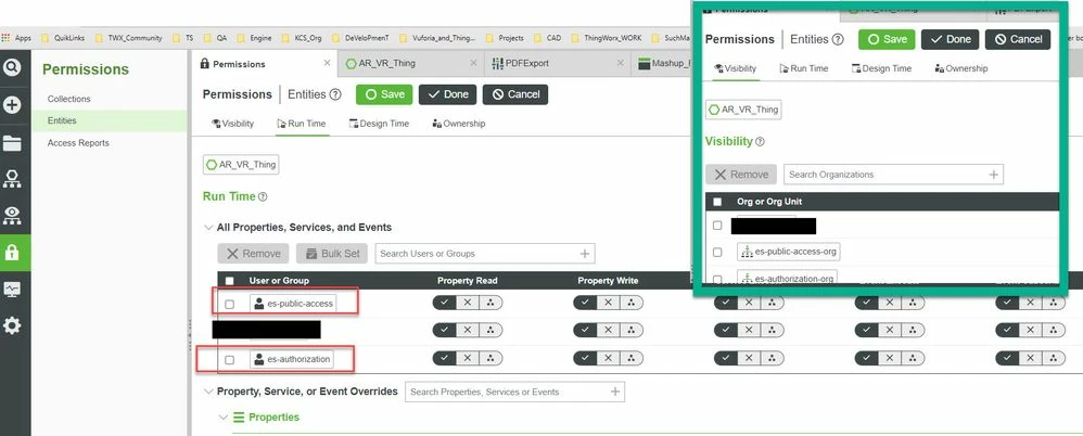

Furthermore you need also to check the permission of the TWX entity what is displayed via the External Data in your Vuforia Studio project. So, e.g. we need to set the thing permissions -here in the example the AR_VR_Thing to set the visibility and the Runtime permission – so that normally to be able to access them in public or authorized projects.

Thank you for your response. The access was public but there were no users specified, so I added permission for public access and it worked.
