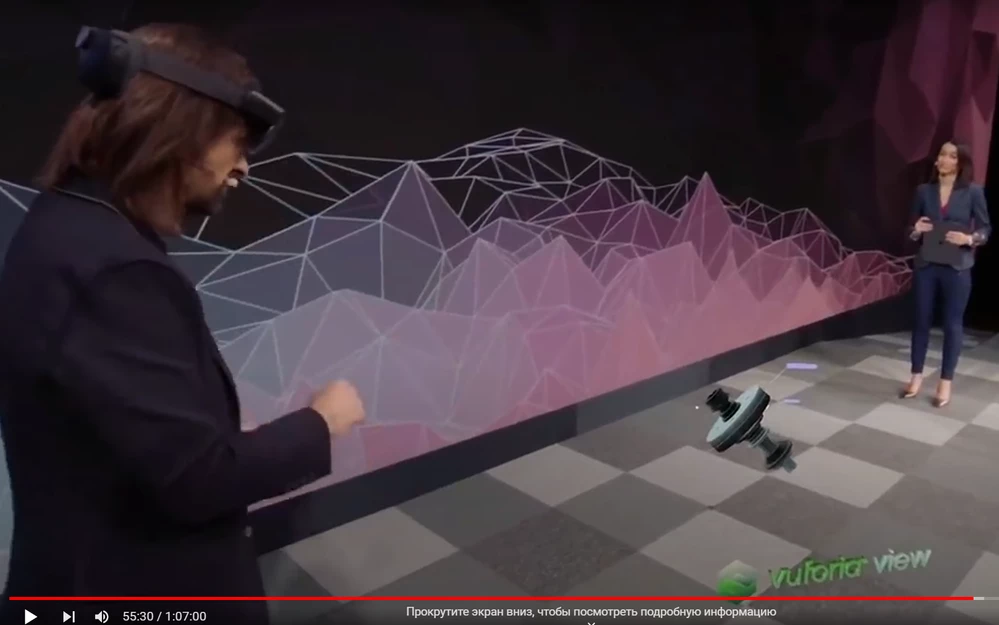

At least I can't do  Experiencer in Vuforia Studio for deveralcollaborated  Vuforia View  users (and several of them can view how one of them operates with AR dynamically); But in MWC 19 (Barcelona 2019)  "HoloLens's Father" Alex Kipman demonstrated how he can use Vuforia Studio (on HoloLens2)  in collaborative work with PTC and Howden  (Maria Wilson) on the one Experience  (see from 52:00 of .https://www.youtube.com/watch?v=fXFc8Tjbq5E&t=3030s)
Wilson describes how Howden prepared Experience with help of Vuforia Studio and then Alex starts thic experience in Vuforia View (on HoloLens). But all participants see this Experience by anothe eyewear - eyewear on camera on stage? operated by cameraman. Camera uses Vuforia View too (the label in left upper corner) and demonstrate all Alex's activities with AR from popint of view camera but not Alex POV. All MWS19 Participants see Alex and Howden experience fron another Vuforia View than Alex and Alex operates in his own Vuforia View in the same time - from MHO it can be as an example of vcollaboration in AR with help of Vuforia view. All collaborators can use theirs own Vuforia View devices to "live" in one AR experience. Moreover, Maria joins with her device  (iPAD may be, vith her Vuforia View) and directs Alex's actions in the presentation of the disassembly-assembly of the AR in Alex's session.
From my point of view - this is a real cexample of "Vuforia Studio collaboration with other users in runtime".
Not?  Several time ago I sent request Julia Schwartz (number One MS HoloLens2 demonstrator and person who knows about MWS19 presentations absolutely all) how they can show the one Experience from two several HoloLenses at the same time (AR collaboration) but she may be very busy and cannot answer.
Anyway, Samuel, do you know who from Vuforia experts could explaine how PTC prepared such example of collaboration in Vuforia Views?
Thank you in advance.
Vladimir.
July 7, 2022
Alex puts on his HoloLens with Vufoeia ViewAlex puts on his HoloLens with Vufoeia ViewAlex starts Vuforia View and see AR assembly from his POV (Front view). But all others can cee the same assebly from another POV (Right side view) which demonstrates another Vuforia View in another device (on stage Cameraman)Alex starts Vuforia View and see AR assembly from his POV (Front view). But all others can cee the same assebly from another POV (Right side view) which demonstrates another Vuforia View in another device (on stage Cameraman)
