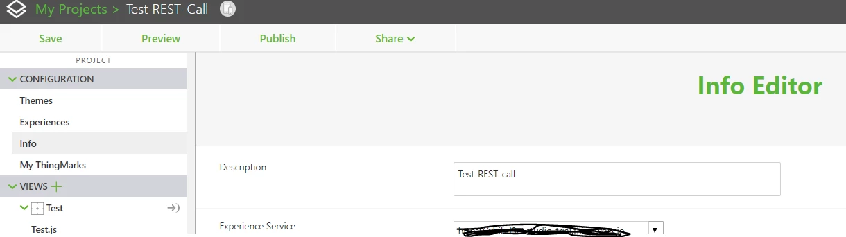

Note: You can login to these URL with the shared Administrator account by provisioning team.
You need ES URL to publish your project and it is also mandatory to put in your Project configuration setting inside Studio application.  Please refer to attachment for details.
From the second URL, you can review the ThingWorx entities and data related stuff using TWX URL.

@bbusschers One URL is for Studio Experience Service where AR project are published and stored. Second URL is for ThingWorx instance which is used for user authentication and required for Studio ES installation & provisioning. So, the Thingworx studio has to be connected to the Thingworx URL.
Your understanding is correct however ES URL needs to be updated in Studio. Starting Studio, go to Settings and add the Experience Service (ES) URL development.
You can use the Administrative account to upload your studio projects. You can refer to our knowledge base articles to learn more about Studio.
