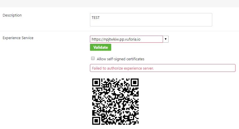

6-Contributor
Jun 3, 2019 8:42 AM UTC
I cannot ping 10.76.68.192.
Jun 4, 2019 7:44 AM UTC
In your second screenshot, it is strange to have the error message Failed to authorize experience service.
I have checked this URL in my web browser at PTC.
I have a Gitlab logo with 404 error.
Best regards,
Samuel
