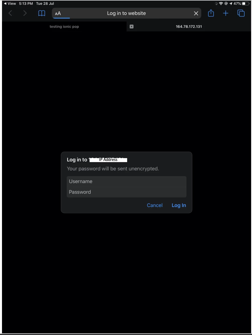

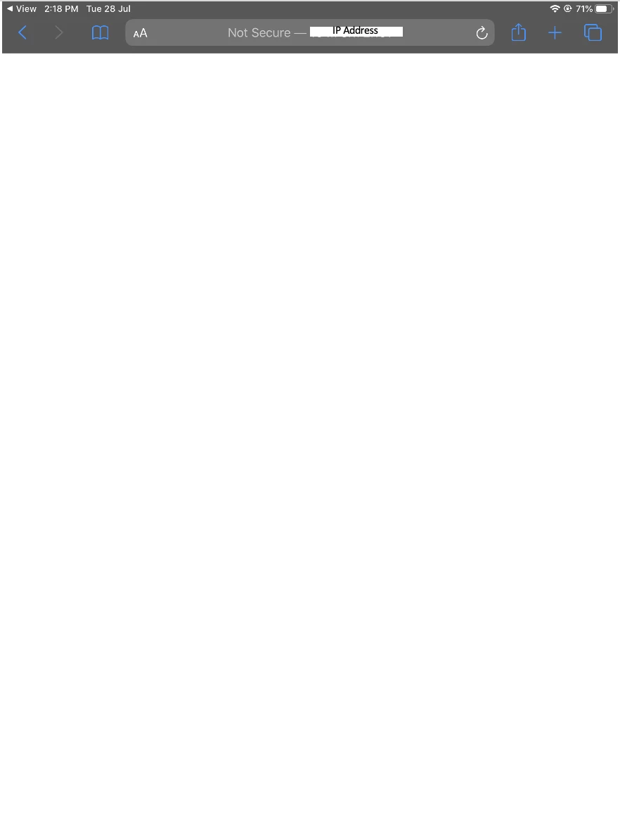

I have an issue where when changing view on iPad, it launches a website and asked to authenticate my log in. After logging in its a blank page.
This only happens when changing view.

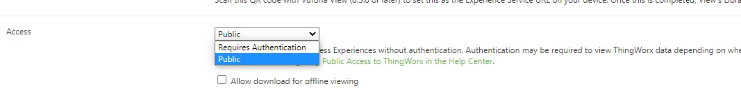

Did you have access to the experience? Or you can set the experience to public before publishing for a try.

check your access in studio info tab and make it public . by this way your problem may get resolved
