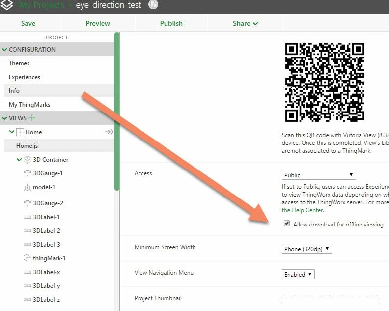

2 things to check:
- to update to 8.3.6 , beause there are some fixes which may be could be helpful.
- the second point is to try to mark the experience to allow downalod for offline viewing:
2018-11-22_12-51-32.jpgI had a case where experience had problem with the connection spead /rate and it  worked only in offline mode.
