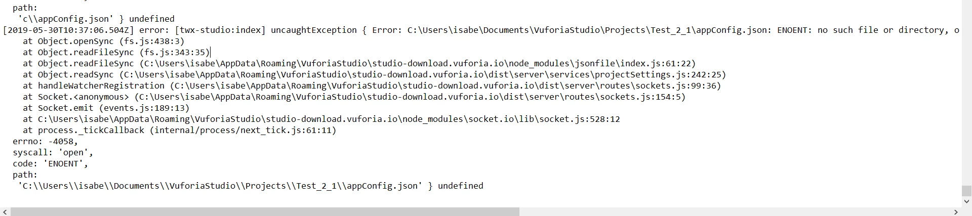

isaAnswer
Jun 19, 2019 7:40 AM UTC
I found the solution on my own, was acually pretty easy. If you convert the .asm file into .pvt and it works without any problems.

thanks @ytella for your answer. This morning I tried it again and now it worked. No idea why, but okay 🙂 Only the experience studio isn´t shown on some mobiles i tried, on others it works
But my bigger problem now is, that when i try to load an .asm file, it is "invisible". Wether in the studio, neither in view, i can see the model, but loading is no problem.
 https://community.ptc.com/t5/Studio/When-I-upload-a-resource-for-a-3D-Model-it-does-not-show-on/m-p/524040#M1504 here a similar problem was already discussed, but no concrete solution proposed
Also I get the attached errors, i can´t save or publish anything. I´m a total newbie, so i don´t understand anything of it.
Jun 6, 2019 7:46 PM UTC
Please share the project file, studio log file and asm model to reproduce the issue. I highly appreciate it if you could provide these details!
