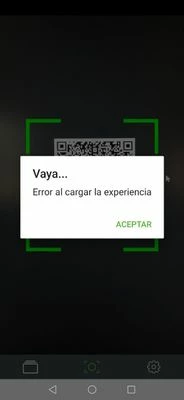

I am having trouble with Vuforia View this time. I checked already all of the entries about the topic but I still haven´t found the solution.

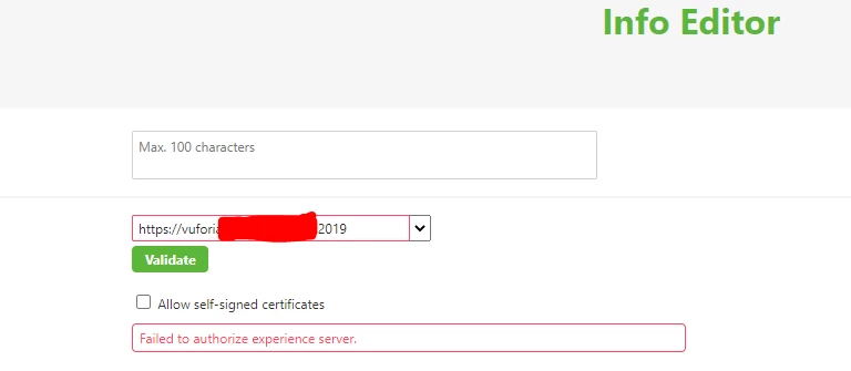

So last time I worked with Vuforia Studio  was two years ago. I don´t remember having to check the "Allow self-signed certificates", but this time I can´t validate the Experience Service without checking this box.
The experience seems to be working in Vuforia View on Apple devices (iPhone and iPad), but not on my  Android phone.
I am not sure if the certificate and the fact that the experience is not loading are related. I attach also the log files. Has somebody an idea why this might be happening?

the self-signed certificate us required (http://support.ptc.com/help/vuforia/studio/en/#page/Studio_Help_Center%2FConfigInfo.html ) when you use self signed certificate on your experience server  if HTTPS. So far I see the picture it is https experience service / on premises . What certificate was used for the installation - self signed certificate? Could you check if the certificate is still valid?(https://www.venafi.com/education-center/ssl/how-to-check-ssl-certificate )
I looked in the log errors : AR_ERROR_NOT_YET_AVAILABLE and  RET_CHECK failure  which is strange - so question is what is the used device - is it an android device supported according to google ARCore supporthttps://developers.google.com/ar/devices
I checked if there are some issue known. I found 2 reported articles at the PTC database and attached here the info and hope that it is helpful for you.:
Error while publishing a Project in Vuforia Studio to an SSL enabled On-Premise Experience Service
Description
  • In Vuforia Studio when trying to publish a Project to an Experience Service on secure connection (HTTPS), the publish might fail and throws an error message "DEPTH_ZERO_SELF_SIGNED_CERT"
  • Studio Project publish fails with SSL error
  • Cause
    Resolution
And another issue
Android devices unable to view Experiences from an On-Premises Experience Service using self-signed certificates
Description
  • Vuforia View showing Unable to connect to an Experience Service. Check your settings or contact administrator error in UI
  • java.security.cert.CertPathValidatorException: Trust anchor for certification path not found in Vuforia View logs from an Android device
Cause
Resolution
