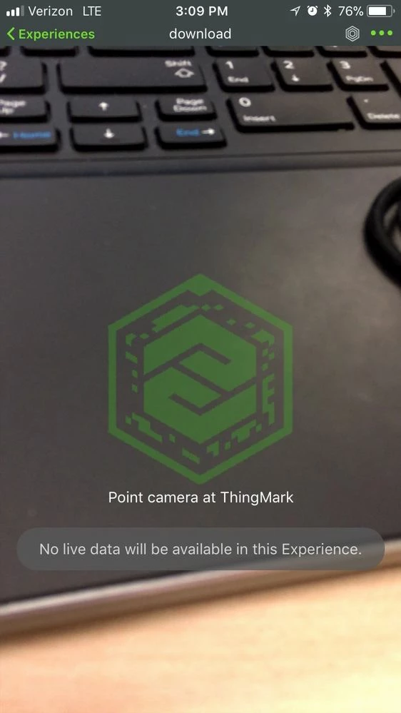

Hi @FireNoodles1
Downloaded experiences are meant for offline use as all content is local to your device. No external calls are being made to the Experience Service or ThingWorx while viewing a downloaded experience. After opening a downloaded experience, a message is displayed briefly noting that live data will not be available.

Hi @tmccombie  thanks for replying
I see... Then I'll have to discard the offline view.
I was trying to download the experience because of some 3D animations that I have, some of then take too long to download and that's causing animation errors (several models disappear during runtime)
