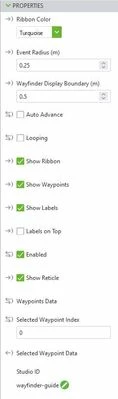

Here the widget setup:
Wayfinder widget propertiesWayfinder widget properties
 I've left "Auto Advance" unchecked to intercept also the 'departed' event, as demonstrated in @ClayHelberg previous post and also because I need certain things to happen before switch to the next waypoint.

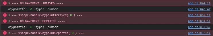

In browser preview everything works as expected:
Events Console PrintEvents Console Print

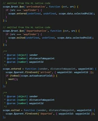

The reason I was expecting to get arguments from the event is because I've looked into "wayfinder-ng.js" trying to understand better how the widget works (usually there are obvious differences between mobile/hololens code) and find this:
It seems the original events (raised by Hololens) are 'arrivednative' and 'departednative' that call 'scope.entered', 'scope.exited' and that finally fire 'arrived' and 'departed' events with an object '{ waypointId: waypointId }'.

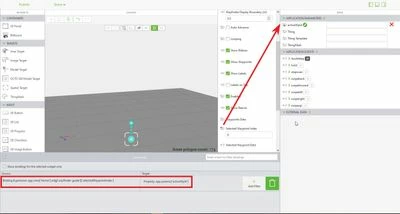

- in alternative we can connect 'selectedWaypointIndex' to a param via drag&drop ex: 'activeWpId'
and than retrieve and use the value from the param when the event occurs like before

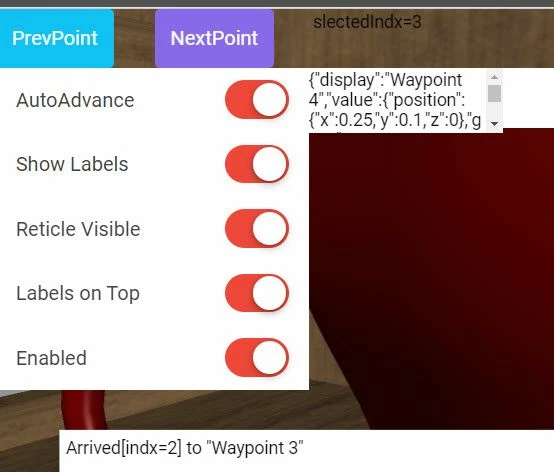

I used e.g. some code like this what was working on mobile and I think  this should work also on HoloLens- for arrive event callback:
$scope.testClbkArrived = function(text) {
 console.log("--->$scope.testClbkArrived ()::");
 for (var i= 0; i < arguments.length; i++)
 {if(DEBUG)console.log('Argument ['+i+']='+arguments[i]);}
 if(DEBUG) console.warn(JSON.stringify($scope.app.view['Home'].wdg['wayfinder-1']))
 let WaypointSelectedIndex=parseInt($scope.app.view['Home'].wdg['wayfinder-1']['selectedWaypointIndex'] )
 let WaypointValue=$scope.app.view['Home'].wdg['wayfinder-1']['waypointsData'][WaypointSelectedIndex].label
 let Waypoi =$scope.app.view['Home'].wdg['wayfinder-1']['waypointsData'][WaypointSelectedIndex]
 //arrived ... you can add there your code when you arrived - e.g. make something visible e.g. below
 $scope.setWidgetProp("textArea-2","text","Arrived[indx="+WaypointSelectedIndex+"] to "+JSON.stringify(WaypointValue));
So ,  In case  that  there are arguments passed this should be reported arguments[] loop but it did not report the argument on my test so I used direct access to the waypoint finder - this work fine sofar if have one wayfinder widget
