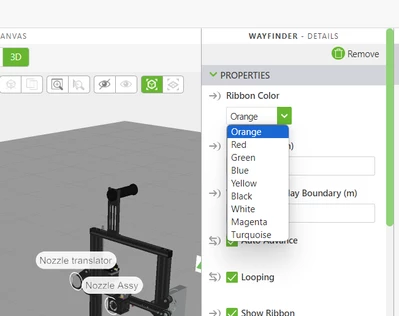

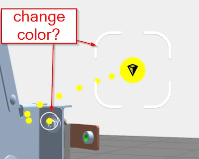

Hi Community
Is there a way to change the color of the reticle and the circle of the Wayfinder widget?
Thanks for your help!
Best wishes
Alex

Aug 7, 2023 3:10 PM UTC
AlexK15-MoonstoneAuthor
Aug 8, 2023 5:34 AM UTC
Hi Steve
Thanks for your reply. I want to change the white color of the reticle and the circle, not the ribbon.
Best wishes
Alex
Aug 8, 2023 6:41 PM UTC
Alex,
Sorry that was a rather a quick answer  and probably  you already knew that!
Currently I don't see any way to do what you want .
Alternatively you could maybe turn off the reticule and add/move a billboard image at the end point - which again you may have thought of
$scope.addImageIndicator = function () {
let data = $scope.getWidgetProp("wayfinder-1", "waypointsData" );
positionImage( "3DImage-Indicator", data[0].position.x, data[0].position.y, data[0].position.z );
positionImage = function (image , x,y,z) {
$scope.view.wdg[image].x = x;
$scope.view.wdg[image].y = y;
$scope.view.wdg[image].z = z;
