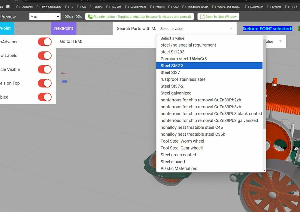

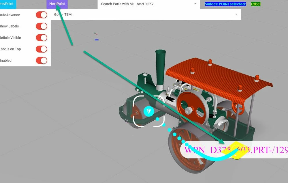

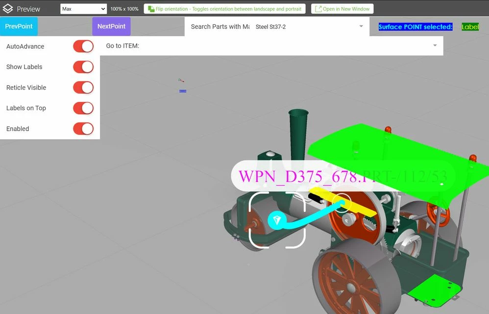

so I did some test in a deom project selecting  a list of component in the meta data via search critieria and then creating list. Using that list then
Using the list I created there dynamicaly (depending on the search resutls) then waypoints data  - so means  that all found elements and create for them items
and we can then navigate to the list of waypoints: with next and prev:
here the highlighting is via script and using a shader.
