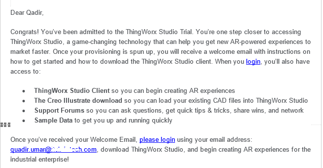

Mar 20, 2017 5:35 AM UTC
hi ,
     I am attaching the mail, which i got from ThingWorx Studio.
Qadir
Mar 20, 2017 6:57 PM UTC
Can you please check your last week inbox? Because, your request was approved last week and you should've received a Welcome Email. May be check your junk mail.

qumar1-VisitorAuthor
Mar 21, 2017 5:15 AM UTC
Hi Giri,
     I have checked my mailbox including the junk mail, i haven't got the mail yet.How can i get that email now?
Qadir
