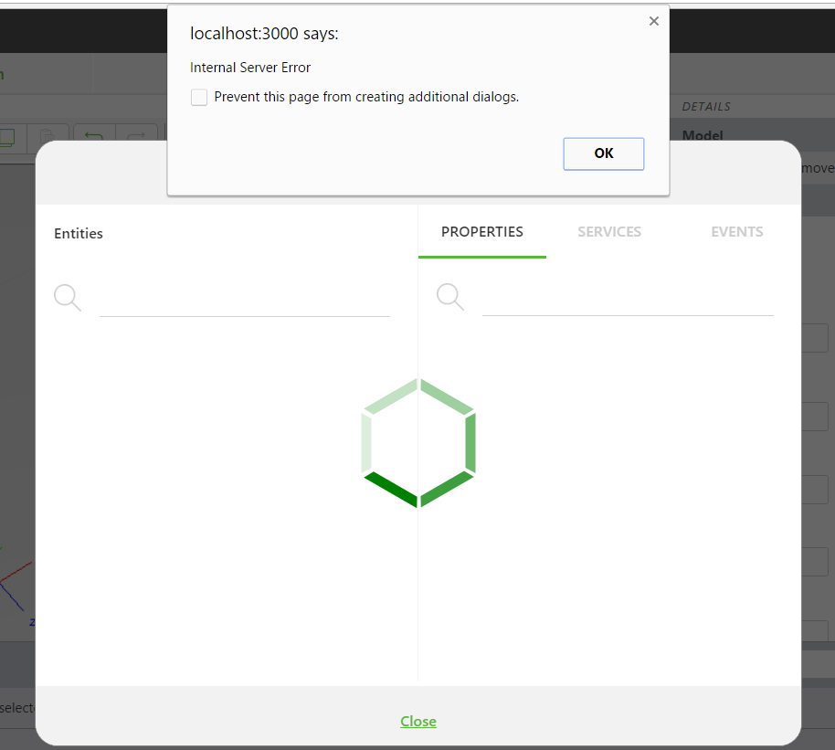

when trying to add external data in thingworx studio, local host 3000 says:internal server error, please help!
I am going through the blue pump case in the thingworx studio tutorial. After drag the 3D label onto the canvas, trying to add external data, met the following error, please help!

Hi Xiuqing Xing​,
Are you able to access the ThingWorx url directly?
The url would be something like https://xxxxxxxx.pp.vuforia.io:8443/Thingworx/Composer/index.html
where xxxxxxxx is your Experience Server domain.
Also, please share the Studio logs for review.

Hi Gupta, .
when I login to thinkworx, my url is  https://developer.thingworx.com/dashboard
There are a lots of this kind of message as attached here in thinkworx log file when trying to add external data for the 3D label.
[15:06:00]  [0mPOST /Thingworx/Resources/SearchFunctions/Services/SpotlightSearch  [31m500  [0m11472.786 ms - - [0m
[15:06:00]  [0mPOST /Thingworx/Resources/SearchFunctions/Services/SpotlightSearch  [31m500  [0m11467.658 ms - - [0m
[15:06:00]  [0mPOST /Thingworx/Resources/SearchFunctions/Services/SpotlightSearch  [31m500  [0m11475.806 ms - - [0m
[15:06:00]  [0mPOST /Thingworx/Resources/SearchFunctions/Services/SpotlightSearch  [31m500  [0m11471.124 ms - - [0m
[15:06:00]  [0mPOST /Thingworx/Resources/SearchFunctions/Services/SpotlightSearch  [31m500  [0m11480.621 ms - - [0m
[15:06:00]  [0mPOST /Thingworx/Resources/SearchFunctions/Services/SpotlightSearch  [31m500  [0m11475.145 ms - - [0m
[15:06:00]  [0mPOST /Thingworx/Resources/SearchFunctions/Services/SpotlightSearch  [31m500  [0m11484.854 ms - - [0m
[15:06:00]  [0mPOST /Thingworx/Resources/SearchFunctions/Services/SpotlightSearch  [31m500  [0m11478.293 ms - - [0m
[15:06:00]  [0mPOST /Thingworx/Resources/SearchFunctions/Services/SpotlightSearch  [31m500  [0m11487.805 ms - - [0m
[15:06:00]  [0mPOST /Thingworx/Resources/SearchFunctions/Services/SpotlightSearch  [31m500  [0m11481.908 ms - - [0m
[15:06:00]  [0mPOST /Thingworx/Resources/SearchFunctions/Services/SpotlightSearch  [31m500  [0m11490.742 ms - - [0m
[15:06:00]  [0mPOST /Thingworx/Resources/SearchFunctions/Services/SpotlightSearch  [31m500  [0m11485.882 ms - - [0m
[15:06:00]  [0mPOST /Thingworx/Resources/SearchFunctions/Services/SpotlightSearch  [31m500  [0m11493.868 ms - - [0m
[15:06:00]  [0mPOST /Thingworx/Resources/SearchFunctions/Services/SpotlightSearch  [31m500  [0m11488.848 ms - - [0m
[15:06:00]  [0mPOST /Thingworx/Resources/SearchFunctions/Services/SpotlightSearch  [31m500  [0m11497.442 ms - - [0m
[15:06:00]  [0mPOST /Thingworx/Resources/SearchFunctions/Services/SpotlightSearch  [31m500  [0m11491.725 ms - - [0m
[15:06:00]  [0mPOST /Thingworx/Resources/SearchFunctions/Services/SpotlightSearch  [31m500  [0m11501.743 ms - - [0m
[15:06:00]  [0mPOST /Thingworx/Resources/SearchFunctions/Services/SpotlightSearch  [31m500  [0m11494.804 ms - - [0m

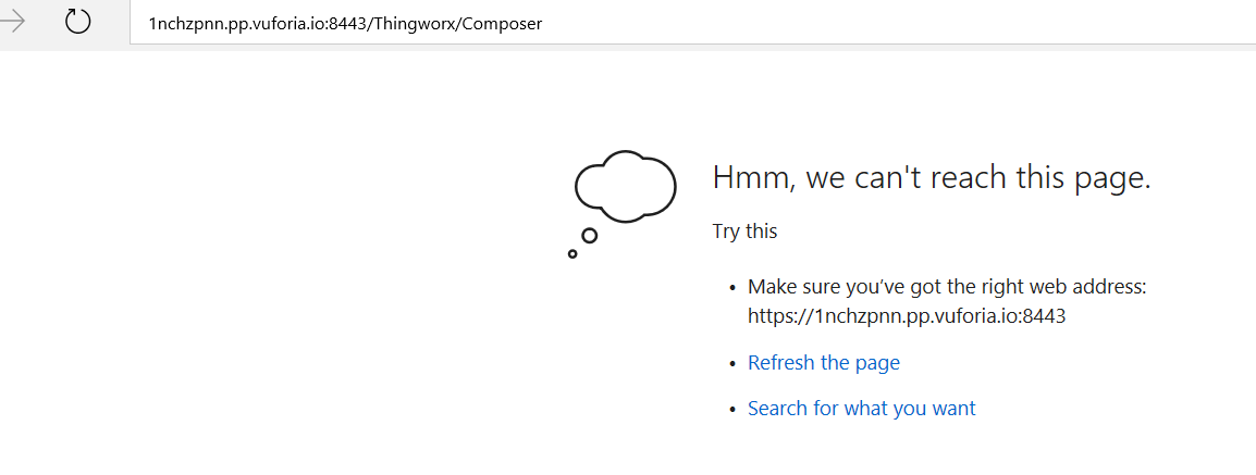

April 24, 2017
Hi Xiuqing Xing​,
Yes, try accessing the following url:
https://1nchzpnn.pp.vuforia.io:8443/Thingworx/Composer
Credentials same as ThingWorx Studio.
Please share the complete ThingWorx and ThingWorx Studio logs
xxing1-VisitorAuthor
April 24, 2017
failed, I cannot reach the page. Error is :
April 24, 2017
Hi Xiuqing Xing​,
That's the issue. I am able to access that url.
Are you able to access the experience service url?
Are you using any proxy to connect to Experience url?
Try from a network outside your VPN/firewall.
