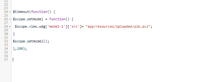

I just tried some code and what you can do is to add some js to override the behavior - e.g.
$scope.populateModelList = function() {
  $scope.app.params.modelselect = [
    display: "Chessboard",
    value: "app/resources/Uploaded/pik.pvz"
    display: "Blue Pump",
    value: "app/resources/Uploaded/sigmatile_anim.pvz"
$scope.populateModelList();
// above is the old code for the select widget
$timeout(function() {
$scope.setmodel = function() {
$scope.view.wdg['model-1']['src']= "app/resources/Uploaded/pik.pvz";
$scope.setmodel();
},100);

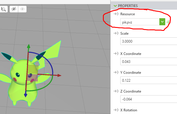

I havent yet seen the example - but i suppose you havent set any resource for model-1 (due to doing it dyanmically through a list).
So I would try to set a model resource fixed under model-1 for your "default" model.
If that doesn't work (or makes the list selection not working) I will tell you a way via javascript.
Martin
Jan 10, 2018 11:39 AM UTC
Hey Martin,
Thanks for your quick answer. That's what i've tried first but it looks like the list overule the model ressource set manually. Whatever i set there, nothing is loaded by default (but still the list works well).

yeah, i thought so ... 🙂
$scope.setmodel();
},100);
