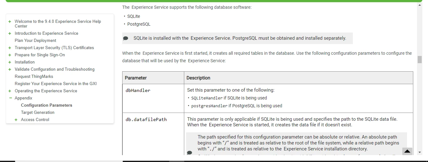

Where should I use configuration parameter for installing experience service on windows?
Hello Community,
I am installing experience service on windows. I installed vuforia experience service .exe file from PTC portal. I selected PostgreSQL as the database type and entered PostgreSQL connection information. But here, I am not able to understand where to use configuration parameters to configure the database that will be used by the Experience Service? How should I do this? Where should I use these configuration parameters? Is there need to configure database?
Please tell me if anyone know about this. Here I attach SS of document please check this.
Aug 9, 2022 8:56 AM UTC
These parameters are only to be setup in configuration.json file.
When using Vuforia Experience Service install wizard, it is done automatically by the fields entered in installed.
In you case, you don't have to take care of that.
