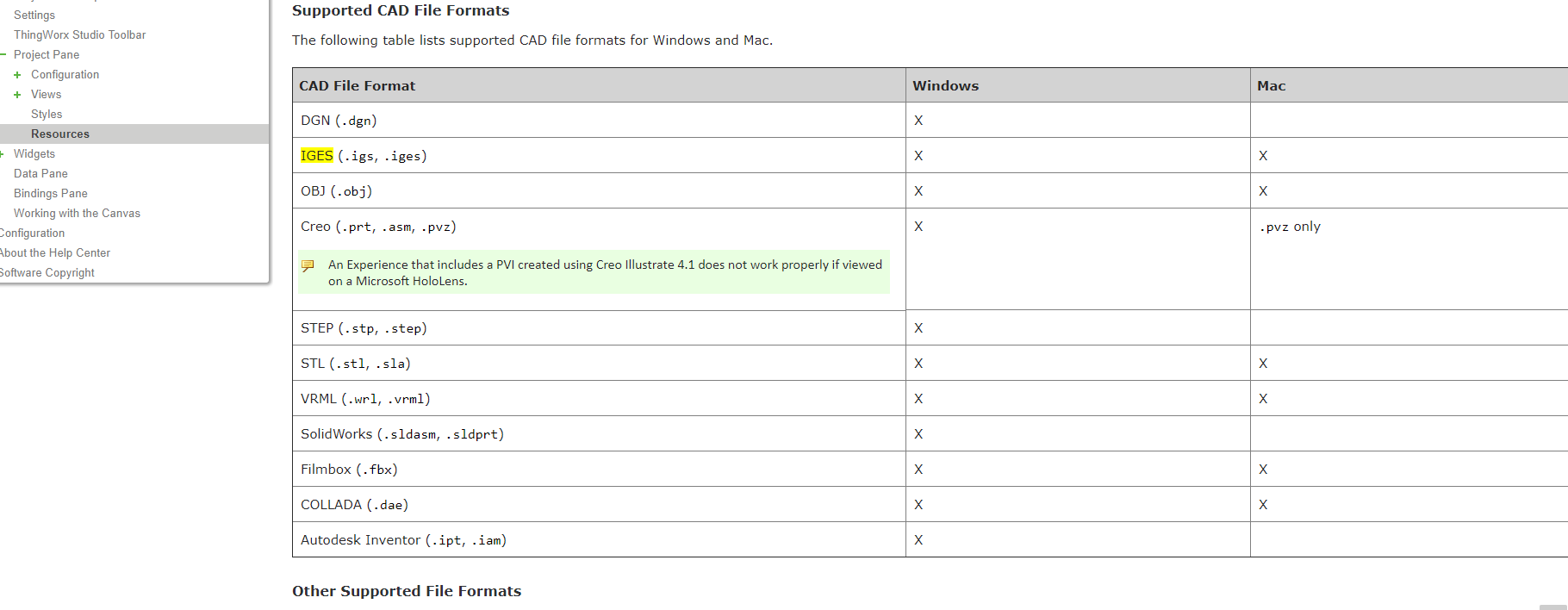

I saw a similar question about this topic in this forum but there is not an answer about it , I would like to know if it possible to import file for example .FBX files or if I have to use exclusively Creo Illustrate ?

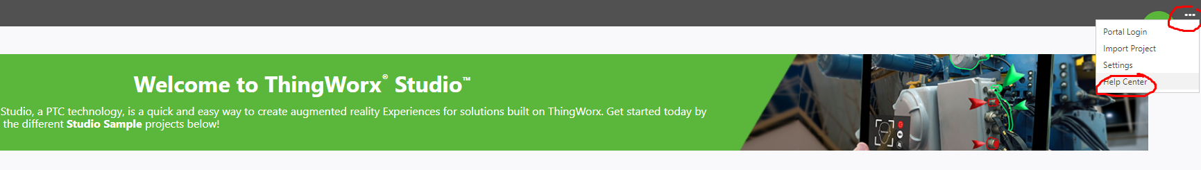

Elias,
the getting started guide would help. But also the help answers that.
Remember when using different formats you won't have the technical illustrations/sequences.
You could import them through creo illustrate as well and animate them accordingly ... e.g. if you think about formats like JT / or other cad formats - that would be one way to go .
Martin
