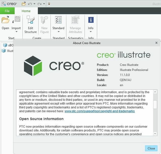

Hi @ptc-1155647,
so one point mentioned in the  Help  What’s New in Vuforia Studio 9.24.0  :
  • Creo files are now supported up to Creo 11.0
So far when Creo 11 is supported as CAD format that indicates that at least Creo Illustrate 11 is supported.
I was not able to find any statements else pointing on the supported version.
I myself currently  use Creo Illustrate 11.1
since it was released and I did not identified an issue but anyway what should work is with Creo Illustrate 11.0
