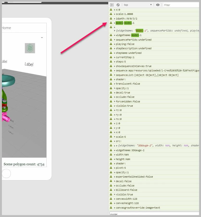

What , I think we can  we can do is to create  list all available widgest (e.g. js) – modelitems  and then to  compare the path to a  component list of the current pvz file – so such list could be extracted by Creo View Toolkit…
To list for example all widgets with properties  we can some construct like:
 var wdgs=$scope.app.view.Home.wdg;
 for(wdg in wdgs)
 { console.warn(wdgs[wdg])
 for (prop in wdgs[wdg])
 console.warn(prop+":"+wdgs[wdg][prop])
This will print some think like:
2019-01-09_15-20-56.jpgOk then later we can make the output  more specfic - where we will print only particular property (e.g idpath when it exist  - it is only specific for modelitems... etc)

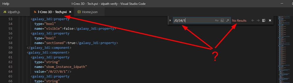

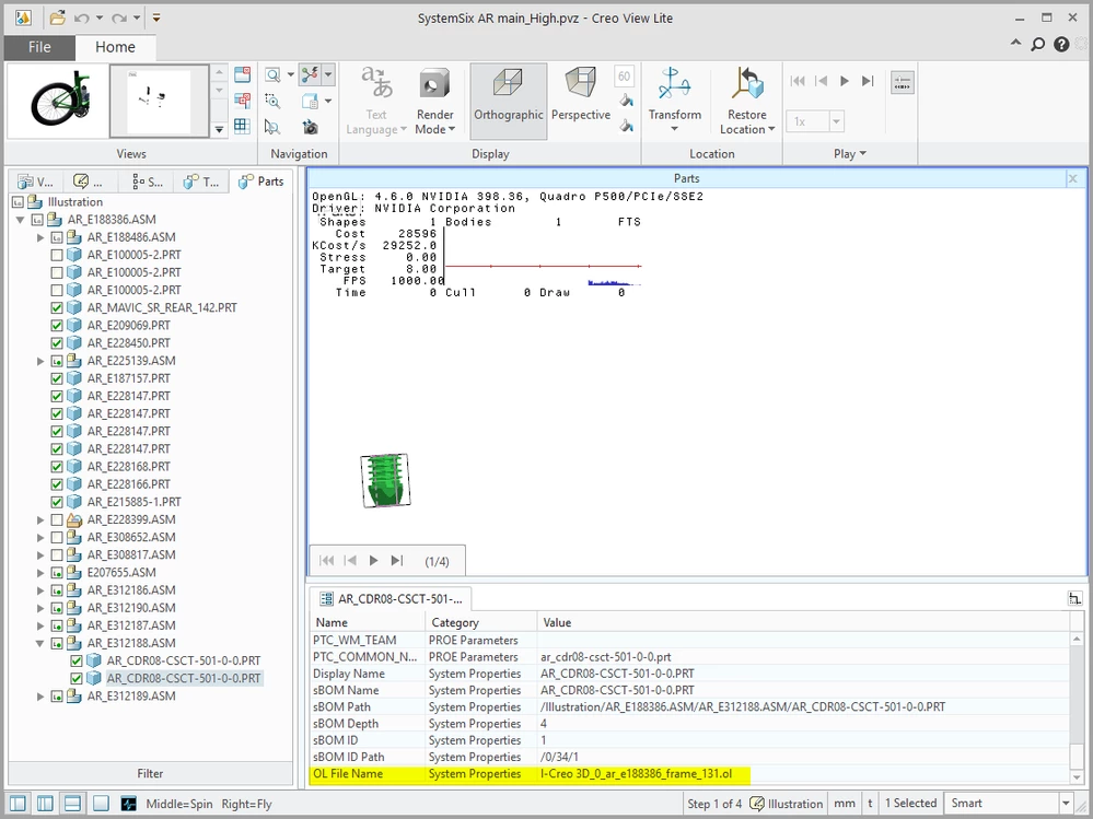

As you mention there are a lot of ways to extract the widgets with occurrence paths but I don't have a good way to find the occurrence paths in the pvz. So I had to write a node.js program to check all the model items against the .pvi extracted from the .pvz. This turned up 8 mismatches, most of them were occurrence paths with an extra "/" on the end. Studio allows you to add a / on the end even if it is not a sub assembly. Not sure if this causes a problem.
However I have 4 modelItems with idpaths that do not appear in the .pvi file. However if I check those modelItems by opening the pvz in CreoView the paths are correct. So maybe the .pvi is not a complete list? Images below of this.
Either way Studio should be producing a meaningful error (even if it is in the Chrome debug console) when it rejects a drag reorder. As you mention you can easily end up with bad idpaths when you replace a model.
2019-01-09 10_49_21-SystemSix AR main_High.pvz - Creo View Lite.png2019-01-09 10_50_01-l-Creo 3D - Tech.pvi - idpath verify - Visual Studio Code.png
