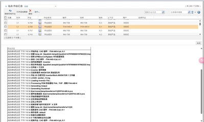

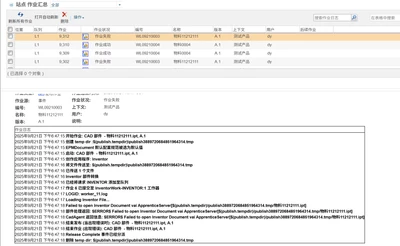

    failure:
    success:

    I assume these were two separate files? Please try this test. Take the same file that failed. Either rename its CAD number and filename to not have chinese characters or do a save as to achieve the same.  See if that then publishes. it will for certain identify a cause. I did not see anything specific about this in the knowledge base.  If no one else responds, next step might be a direct tech support call with PTC.
