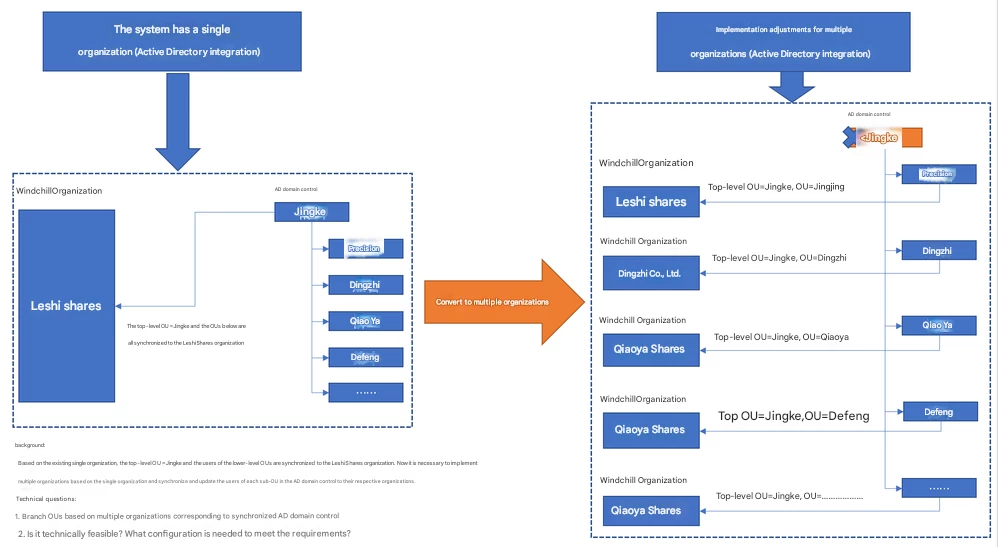

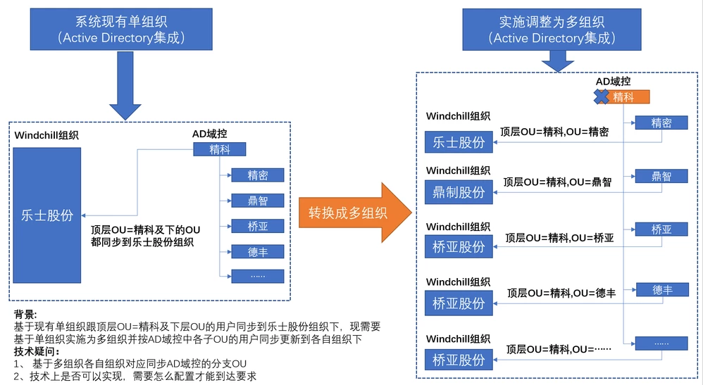

单组织跟Active Directory集成,调整为多组织跟AD域控各分支分开集成疑问解答
I am using Windchill PDMLink Release 12.1 and Datecode with CPS 12.1.0.2
1、现有系统单组织跟Active Directory的顶层OU集成,同步更新所有分子公司的用户到Windchill的单组织下
2、先需要基于多组织,Active Directory怎么根据各子公司树分支OU的用户同步更新到对应组织下

Jun 27, 2025 3:02 AM UTC
您好
背景:
基于现有单组织跟顶层OU=精科及下层OU的用户同步到乐士股份组织下,现需要基于单组织实施为多组织并按AD域控中各子OU的用户同步更新到各自组织下
技术疑问:
1、 基于多组织各自组织对应同步AD域控的分支OU
2、技术上是否可以实现,需要怎么配置才能到达要求?
Jun 27, 2025 11:58 AM UTC
Wish the community forum translated images.  This is what I got out of Google Translate.
Sure, that is possible.  Fun and easy, maybe not, but possible.  It depends if you want to flip the switch over a weekend or you want to unravel these one 'organization' at a time.
Each base DN will need a JNDI Adapter setup.
The user migration process varies.  The rule is Windchill can't see the same username through two different JNDI Adapters.
Isolation is possible by using different unique ID mapping attributes: sAMAccountName and userPrincipalName.
Not changing the unique ID, if doing it one organization at a time, define security groups for all existing users and for each of the new organizations/LDAP servers.  Remove users from the old 'filter group' and add them to the new filter group.  Then repair their accounts.
