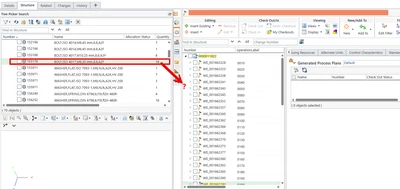

如何在process plan 中确定零部件是来自于Mbom中的哪一部分
  • January 23, 2026
  • 2 replies
  • 143 views
在学习创建process plan / work element .
如下图,我该如何查看在左侧的MBOM结构视图中的某个部件,被分配去了process plan中的哪项work element ?

Take a look at https://www.ptc.com/en/support/article/CS454485
we can define an alias attribute on Part to show the consuming Operation
