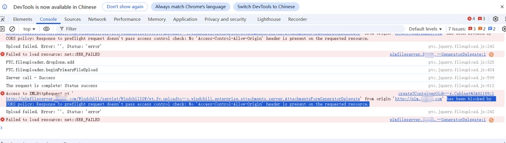

客户本地选副本站点上传文件失败,但是服务器上可以正常上传
I am using Windchill PDMLink Release 11.0 and Datecode with CPS M030-CPS22
客户端本机选择-副本站点,上传文件没有反应,F12报错:has been blocked by CORS policy: Response to preflight request doesn't pass access control check: No 'Access-Control-Allow-Origin' header is present on the requested resource.
但是在副本的服务器上或者主站点的应用服务器上是可以上传的。
    Aug 4, 2025 8:47 AM UTC
    在codebase/WEB-INF/web.xml中加了 <filter>

    后重启了还是不行
    F12报错
