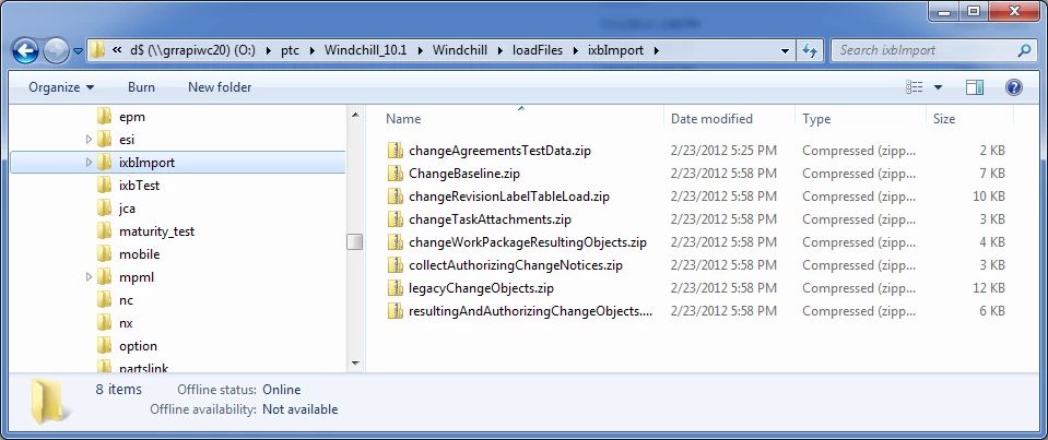

If you look in <wchome>\loadFIles\ixbImport
There are several example files
[cid:image002.png@01CD6F12.EF0E7910]
July 31, 2012
This is the output from my "windchill version" command and a screenshot of what's loaded in the ixbImport directory. I do not have any business*.zip files. My 10.1 M010 system was upgraded from F000.
