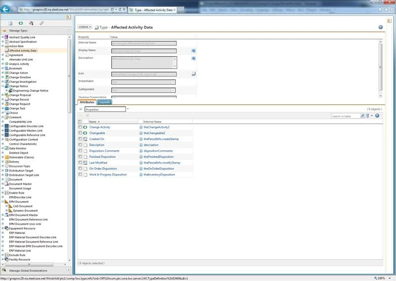

Has anyone had to add additional (new) disposition types (columns) to the AffectedActivityData link?
I have been requested to add two additional disposition columns to the affected items table.
I have looked up this customization in the guide, but thought I'd ask if anyone has done this before, and if they have a condensed how-to on doing it (especially on extending the default table builder classes and other files that need changes).

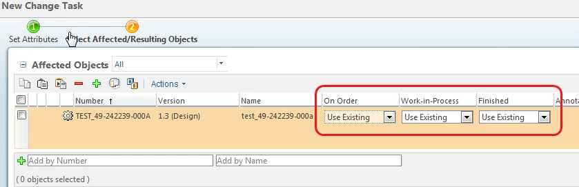

All,
Attached is a ZIP file with a working customization for adding 2 disposition columns to the change task and change notice affected items tables.
Contained in the zip file is a word document with the installation directions.
If anyone has any improvements on this, please let me know so I can incorporate it into the code.
Many thanks goes to Stéphane Mainente from PTC tech support, for providing direction and much of the code.
