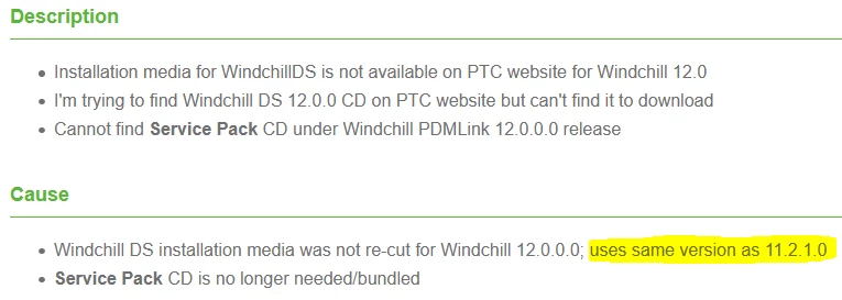

I actually missed this, probably because during the original 12.0.0.0 installation I had followed the recommendation in CS326880 to use the 11.2.1.0 version.  Updating later on to 12.0.1.0 didn't complain about continuing to use this version...
For others who also missed this, here's a TS article talking about what to do going forward:  CS335692
