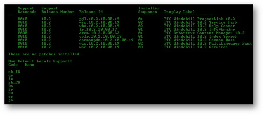

Apr 9, 2015 1:46 PM UTC
I don’t understand this Info modeler requirement as I’ve changed the the number of characters in my system for WTDocument and I don’t have it, maybe this requirement refers for PDMLink types such EPM and WTPart…
See the modules I have installed:
See the procedure I’ve used as reference:

BenPerry
Apr 10, 2015 10:40 AM UTC
I was able to get to Step 3. But when I tried the ant command on our Unix system, I got an error message. When I opened a ticket with PTC tech support, they told me I couldn’t execute the command with the custom_column switch because I didn’t have Information Modeler installed. This was back in 9.1.
ant -f <windchill>\bin\tools.xml custom_column -Dgen.input=wt.doc
This warrants a 2nd look now that we’ve upgraded from 9.1 to 10.2, and you’ve reported that it works. I will give it a shot! I would like to increase the character limit in Windchill for WTParts for the Name attribute…in order to match the character limit of our ERP system. 120 characters, I think.
