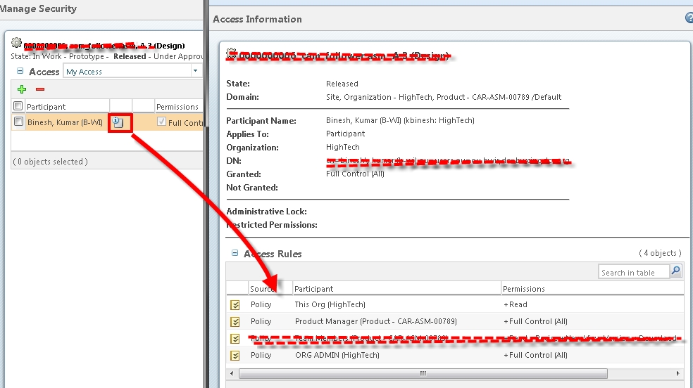

A member can search and find a document although that member is not added to related product team !!
How can I fix this security problem ?
Thank you.
2-Explorer
August 27, 2015
Please use manage security for that object to see how the access has been granted. Refer to Troubleshooting Access Permission related issues in PTC Windchill
manage_security.jpg'
