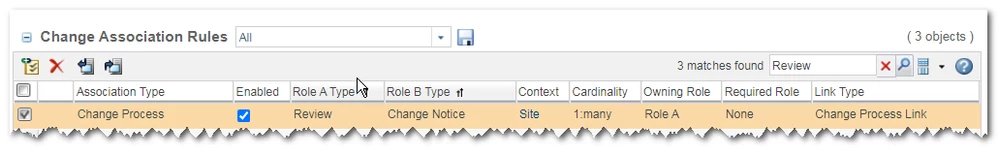

Ability to associate Review Object to Change Task
Is there an ability, configuration or simple customization, to associate a Review Object (Design Review/Peer Review) to a Change Task?
Currently there is no Associated or Reference Process Object table on a Change Task. A similar question could be posed for Problem Reports associated to Change Tasks. We often break down our design into CT chunks, releasing at the CT level, and are looking to associate this information to better link the data at the lowest level instead of at the Change Notice/Change Request level. Right now we're just looking for linking, not closure hierarchy or workflow trickery (yet).
One would think the Role A/Role B Change Association rules could be configured to allow for this, then the table added on the change task for visibility, though not sure if the system will allow for that functionality.
Any thoughts?

Mar 8, 2022 4:26 PM UTC
Change Tasks can only exist in a Change Notice.
You can create a Change Association Rule between Review and Change Notice, then you can link Change Tasks to Reviews via Change Notice.
Review - > Change Notice - > Change Tasks

HelesicPetr
Mar 9, 2022 7:13 AM UTC
Hi @rhart
I was thinking to advice this solution, but I found the requirement that one Task should have one Review or more.
With your solution there could be good idea to use one Notice for just one Task, then your idea is acceptable from my point of view.
