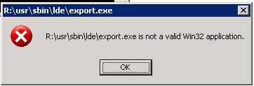

The export.exe in our Windchill installation is of 0KB and if we run it in we get the following error:
Folks!- Please let me know if Aphelion backup is necessary apart from the above LDAP backup.
