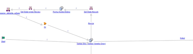

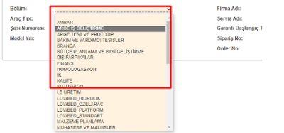

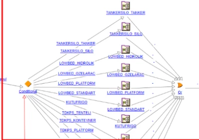

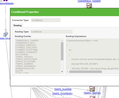

hello, I have a workflow and in this workflow, the flow goes to different parts according to the values ​​in the global enumeration in the attribute in a particular layout. In fact, I make users choose a section, and as a result, the flow progresses according to the selected section.
The problem is that I do this for each partition and I have 30 partitions in total. which means task and etc required for 30 sections.
How should I use something here so that the participant I selected directly finds the role or group in the enumeration?

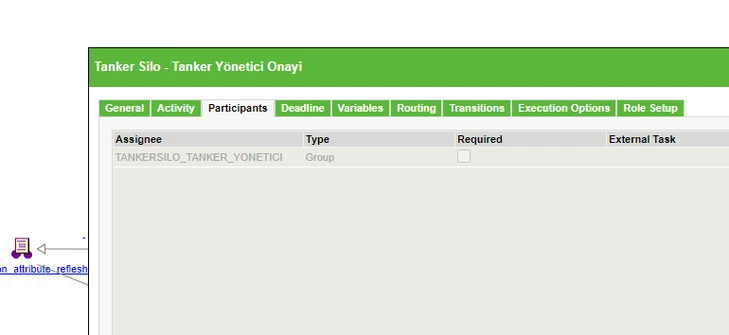

there is only task inside the blocks. I'm sending a task to a user whose name I just specified. For example "tanker silo manager".

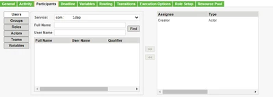

What does submitter do?
I can direct the flow according to the section selections entered by the users, but when I want to send the tasks to the necessary people, I have to choose a separate participant for each section, which intensifies the flow. Is there any way I can do this problem in a single domain?
I can select participants according to the section selected below, but I need to create another one for a different section.
