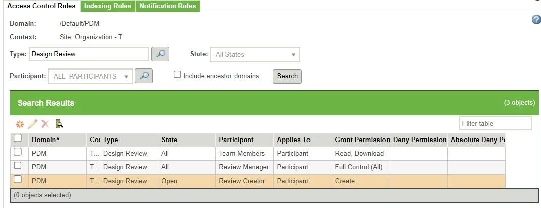

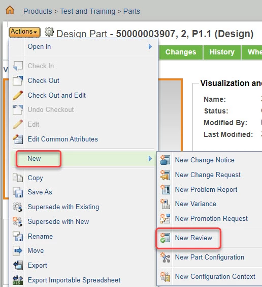

I wanted to test the Design Review feature on an item (WTPart for example), and it all works fine as admin, but as a Regular Joe with decent access in a Product, I get an access error.
I've checked the ACL, it's set up OoTB (see attached pic). AFAIK, no good help to be found from PTC pages such as this one.

@Fadel and @HelesicPetr , huge thanks for your help and input, it enabled me to solve this. Looking at a Design Review in Open state (not submitted) showed only Product Manager role has full access, Team Members only have Read and Download (which I should've known already).

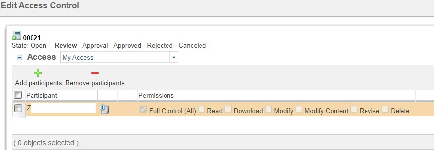

login as normal user and  go to info page of an existing review object , click on action > Edit access control and look  for your effective permission

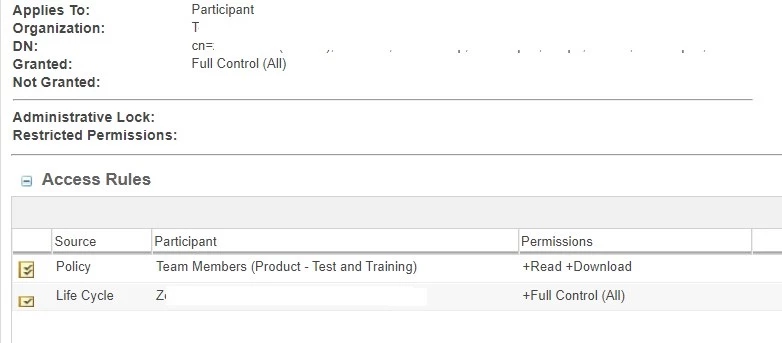

That looks as should... Full control. Access Rules look less though.
I'll look at wt.access.evaluation.report, thanks.
