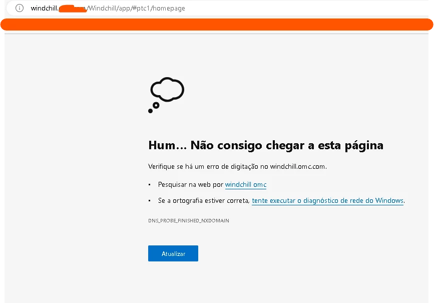

Access Windchill on the network
I'm trying to access my Windchill on my network, this server is not in the domain, plus ping on its normal IP do I need to release something else for internal access? Today I'm using http.

Hi @MS_Santos
If the system is not in domain you need to use host file where you define the server address and IP address
also check firewall

MS_Santos15-MoonstoneAuthor
Aug 8, 2023 1:50 PM UTC
But what do I have to put there? this address? http://windchill.omc.com/
HelesicPetr
Aug 8, 2023 1:51 PM UTC
Hi @MS_Santos
Address without http
192.168.1.55 windchill.omc.com
