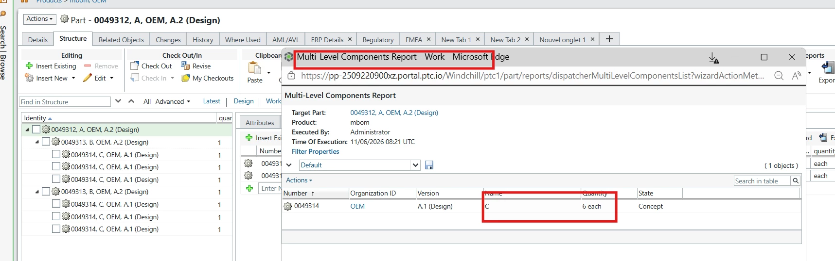

accumulated quantity of BOM
I am using Windchill PDMLink Release 11.0 and Datecode with CPS M030 假如A 下面挂3个B ,B下面挂2个C,如何设置BOM视图在查看A的BOM结构时可以查看和导出这个数量6?

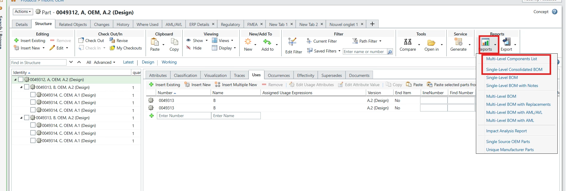

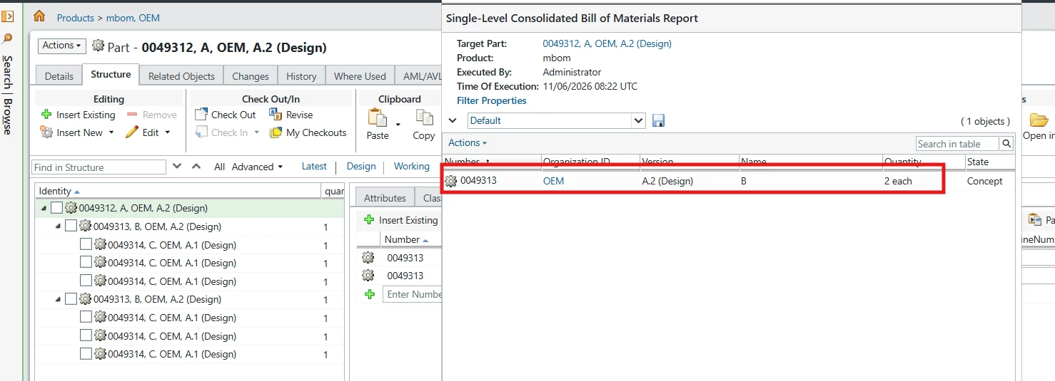

you can use below report on the PSB , and export to PDF ,EXCEL , HTML or TXT :
