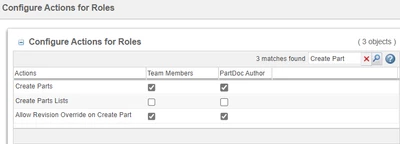

8-Gravel
Apr 23, 2024 5:17 PM UTC
Actions on "PartDoc Author" role are set as-expected. --> RRAKOTOV_1-1713892522569.png
I will continue to investigate !

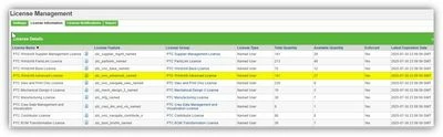

Check also the license applied to the test user.
RRAKOTOV8-GravelAuthor
8-Gravel
Apr 23, 2024 5:13 PM UTC
Licensing is OK
--> "PTC Windchill advanced" is not fully used

Have you tested in multiple Products/Libraries? Have you tested with multiple test users? Is it the same in all cases? A lot of times with access the easiest way is to find a case that works and then try to determine what is different between working case and non-working case.
There can be a lot to check for an access issue (and probably more than what I can think of):
  • License(s) applied to the user
  • Profile(s) applied to the user
  • ACLs at the Org-level
  • ACLs at the Product/Library level
  • Role(s) that the user is in within the Product/Library
  • "Configure Actions for Roles" set within the Product/Library
  • folder-level Access Control (if set)
Also be sure to consider the type of part being created and the OIR for the part at the Org level and the Product/Library level. The ACL granting create must grant create for the type/subtype and correct state.
Also if you have any customizations, these can impact as well.
