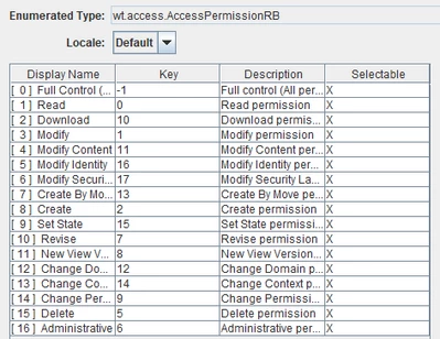

There is an RBInfo file for this: wt\access\AccessPermissionRB.RB.ser
May 22, 2025 6:58 PM UTC
May 22, 2025 7:00 PM UTC
Hit "send" too early.  These are all the defined keys.  Maybe those numbers were used ~25 years ago and later deprecated, but they are not used today.
