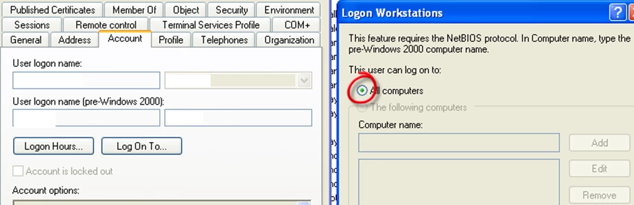

This works. The user can log into PDMlink
[cid:image001.png@01CCF7B8.FEF209E0]

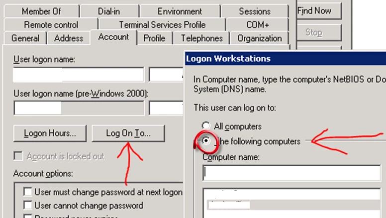

This doesn't work. The user can log into the machines but not into windchill.
[cid:image002.png@01CCF7B9.46DF46F0]

Is there a load balancer or proxy in the windchill deployment? You may need to add other hostnames besides just the application server?
