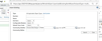

Add Search Field Options for Product Structure Browser Action Replace with Existing
Version: Windchill 13.0
Use Case: Expand fields of search for PSB action Replace with Existing
Description:
We would like additional search fields for the following PSB action Replace with Existing
We can do this for the Insert Existing; but not Replace with Existing.
Based on our research, the following was observed:
The Replace With Existing action search window is implemented with a search UI which is tightly coupled with OOTB AdvancedReplacementAddPartAction class, which we we were not able to add custom IBA as search criteria field.
Is there a way around this limitation?
Fadel

There is no setting for replace with existing on on insert existing we add attributes

Oct 22, 2025 11:43 AM UTC
Are you looking to do customization? This appears like it should be moved to that channel if so. @Fadel , not following your image. Appears you have added attributes to your search but did not document how. Appears that you were showing Insert Existing UI. Is your modification documented anywhere?
