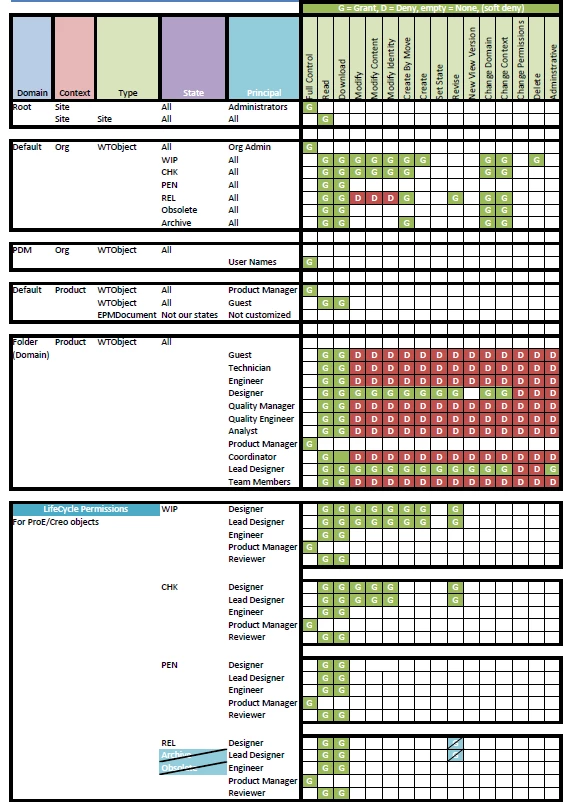

Mar 27, 2015 8:27 PM UTC
I wish it were that easy. A former employee who went to work for PTC came back and set up our system on rev 8. It was his first installation, and we didn’t know enough, to know what not to ask for or to recognize that certain configurations would be a problem.
We ended up with multiple orgs and permissions set up like shown below. We are in the process of installing fresh on 10.2 and doing a migration of our data to eliminate this mess.
[cid:image001.png@01D06891.CCA44A50]
