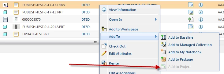

In 10.2-m010 I was able to RMB on a selected item and from that menu pick Add to Project.
In 10.2-m020 this menu is grayed out.
[cid:image001.png@01CFD97E.B8382E30]

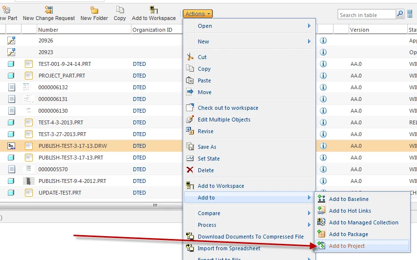

However on the same page, if I pick Actions pull down menu then Add to Project is available and it works. I am able to add to a project.
[cid:image002.png@01CFD97E.B8382E30]
Anyone seen this. Is there a setting that is causing the problem?
The TSE got the following response from R&D which wasn't helpful.
When the "Add To Project" action is disabled, it typically is because the user does not have all the required permissions to share the particular object. The action from the "Actions" menu does not validate to the same granularity.

That is odd, but the TS statement appears to be correct. As a Project Manager, I can share the file using either UI. As a Project Member, I cannot share via RMB, just as you have shown.
If you attempt Add to Project using the Actions menu, can you complete the process? If you cannot, then the TSE is correct.
PTC does do some additional processing of the RMB Actions compared to the Actions menu in the toolbar. All the RMB actions are validated based on your account permissions where the Actions button in the toolbar is not.
Either way, it should be consistent.

After doing some more testing today, it appears that it's an isolated problem to a Product. I'm not sure if others have the issue or not. But most don't have the issue.
I just happended to pick the one that had problems.
