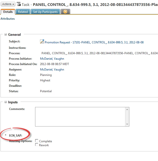

Guru's,
We would like to add a value to our Promotion Request attribute ATT1, while the PR workflow is executing. Ideally, this would happen by a user entering it into the TASK, next to the comments field. Is it possible to add an attribute field to the task, that can push to the PR object?

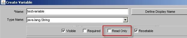

Aug 8, 2012 7:20 PM UTC
Must have "read only" checked for the variable for it to display this way.
[cid:image002.png@01CD7560.40DE8ED0]
