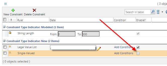

       I hope, you would have been added the attribute value in the legal list with pipe symbol separated. The attribute values should automatically come as a drop down or else try to edit the attribute and select the selection list style to drop down.Attribute - Complexity.png

That was part of the problem, I had Suggested List instead of Legal List. Where is this stuff documented?
Still having a problem getting it to add multiple lines. I do have a constraint specifying Single Value that cannot be disabled or deleted. I think I selected that in the initial add of the attribute. Might need to add another column and create a new attribute for test purposes.
Sep 18, 2015 3:46 PM UTC
Disabling single valued constraint is possible by editing soft-type and unchecking that constraint.
After saving changes, plus icon shows next to attribute and multiple values can be added.
