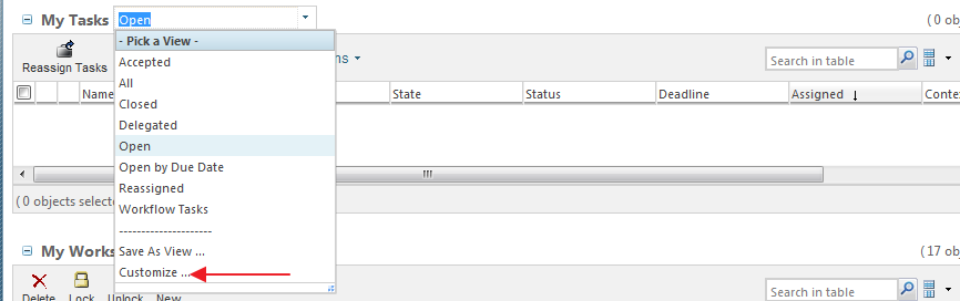

Adding columns to display on home page - My Tasks

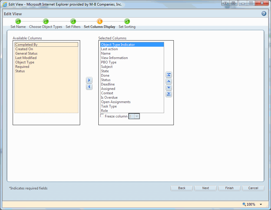

Does anyone know where I have to go to add a column to the list of available columns when customizing a My Tasks table view? I was able to add the column on our Change Notices page (browse>changes>change notices). I just need to display on people's home page. Currently it's not listed in the available columns to add.
Thanks in advance,
Greg

Right next to "My Task" is a drop down, you can select "customize" and create your own view with any columns you want.
GregOlson16-PearlAuthor
Jul 17, 2014 8:17 PM UTC
James,
I am asking how to add a column to the available columns list....
Jul 17, 2014 8:19 PM UTC
Sorry I misunderstood. Too bad, here I was thinking I may have actually solved someones windchill problem. I don't have an answer for that problem.

I also logged a case with PTC, here is the TSE's response:
I have been assigned to look into this issue. After doing further investigation, I have found below steps to add column to users Home -> Tasks table.
  • <WT_HOME>\codebase\WEB-INF\jsp\object\homeAssignments.jsp generates the My Tasks assignment table on Home Page.
  • If ProjectLink is installed the table id assigned is projectmanagement.overview.assignments.list and the table is defined in com.ptc.windchill.enterprise.work.mvc.builders.OverviewPlanAssignmentsBuilder ComponentConfigBuilder.
  • If ProjectLink is not installed the table id assigned is netmarkets.overview.assignments.list and the table is defined in com.ptc.windchill.enterprise.work.mvc.builders.OverviewAssignmentsBuilder ComponentConfigBuilder.
  • Workaround:
o Override/extend the corresponding builder to override the getSpecialTableColumnsAttrDefinition method to add the required column.
o Create a new DataUtility to fetch the column values

GregOlson16-PearlAuthorAnswer
Jul 24, 2014 12:14 PM UTC
From our consultants:
1. Edit AvailableAttributes.xml Windchill\codebase\com\ptc\core\htmlcomp\createtableview\AvailableAttributes.xml and add following lines under WorkItem (Add highlighted lines)
<Class name="wt.workflow.work.WorkItem">
<Include name="wt.fc.Persistable"/>
<Include name="wt.ownership.Ownable"/>
<Attribute id="completedBy"/>
<Attribute id="name"/>
<Attribute id="reassigned" type="boolean"/>
<Attribute id="required" type="boolean"/>
<Attribute id="role" type="list" enumClass="wt.project.Role"/>
<Attribute id="workItemStatus" schemaId="status" type="list" enumClass="wt.workflow.work.WfAssignmentState"/>
<Attribute id="containerName"/>
<Attribute id="workitem_pbolink"/> <Attribute id="SaledOrderDescriptionWorkItem">
<Label resource="ext.mb.MBResource" key="SALES_ORDER_DESCRIPTION_LABEL"/>
</Attribute>
<Attribute id="SalesOrderNumberWorkItem">
<Label resource="ext.mb.MBResource" key="SALES_ORDER_NUMBER_LABEL"/>
</Attribute>
</Class>
2. Edit the Windchill\codebase\com\ptc\windchill\enterprise\enterpriseui.dataUtilities.properties.xconf and add the following lines under the <Service name="com.ptc.core.components.descriptor.DataUtility"> tag:
<Option serviceClass="ext.mb.CustomChangeNoticeAttributeDataUtility"
requestor="java.lang.Object"
selector="SaledOrderDescriptionWorkItem"
cardinality="singleton"/>
selector="SalesOrderNumberWorkItem"
3. Run "xconfmanager -p" to propagate the changes.
4. Place the DataUtility files under Windchill/src/ext/mb folder (create folders if necessary)
5. Execute the below command to compile the classes:
tools class -Dclass.includes=ext\mb\**
6. Restart the server and add the column to the view.
Works Great!!
