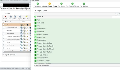

Adding Global IBA to Resulting Objects Table On Task Activity Page
Version: Windchill 12.1
Use Case: I need to add an IBA that is only filled out or shown in the Resulting Object table of a Change Notice/Activity and stored per item in the table.
Description:
It cannot be filled out generically as an IBA against the Notice/Activity and it cannot be an IBA at the EPMDocument or wtPart Level.  I added a global IBA to the Change Record table, but it doesn't show up in the list when I try to create/update a view that will then contain that IBA.  How do I do that?

OOTB it is a dead end the change record is not part of the types intended for this table :
as you may see on https://www.ptc.com/en/support/article/CS65983 the  change record attribute not intended to be used in UI .

Oct 3, 2024 6:11 PM UTC
Thank you Fadel!  I was hoping that we could avoid some customization.
Oct 5, 2024 1:03 AM UTC
Check out https://support.ptc.com/help/wnc/r12.1.1.0/en/index.html#page/Windchill_Help_Center/customization/WCCG_BusLogicCust_ChangeMgmt_EditAttrChangeRelTable_Overview.html# for information on the steps.  Help center -> Advanced Customization > Business Logic Customization > Customizing Change Management > Addition of Attributes on Links in Change Relationship Table > In-line Editing Attributes on the Links of Change Relationship Tables > Overview
