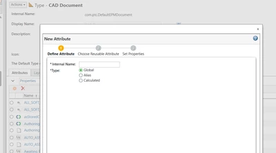

 Standard/local attributes are not supported on EPMDocument and its subtypes (CAD Documents, ECAD Documents, Dynamic Documents ...) as per decisions made since Windchill 10.0
Even if added attribute to DB, there is no UI way to do this
