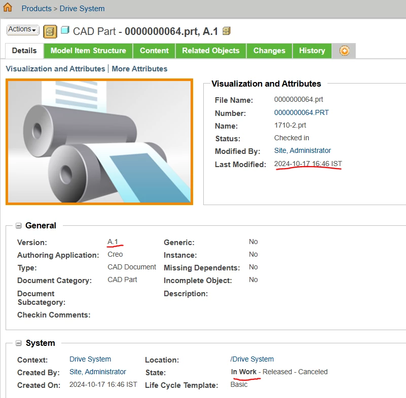

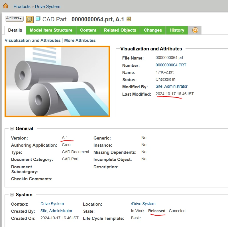

Nov 20, 2024 11:19 AM UTC
I have attached screenshot explaining it.
CAD Part last modified on 17th Oct but released on 20th Nov. Still it shows last modified.
This is because model is not changed.
But in our case we dont want model last modified date. We want model released date. Can we get it in Creo Parameters?
Nov 20, 2024 2:55 PM UTC
You can probably do this with custom coding.
The release process is only done in Windchill and does not affect the Creo drawing. or change the last modified date of the file in Windchill.
In order to do what you want, the release process would need to open the file in Creo and then resave it to Windchill in order to get the date changed. However, this leads to the object being iterated so it is no longer A.1 but now A.2 and A.2 is not what the promotion request is releasing.

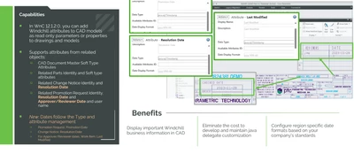

Are you using Windchill 12.1.2.0 seems that this feature is now available.

There are two aspects.
  • When you open the native CAD drawing connected to Windchill - Then the attributes will be updated in the drawing titleblock when opening the drawing in Creo.
  • When you generate the viewable - If you trigger the viewable generation upon promotion request approval (which is OOTB) the CAD worker opens the drawing for conversion and should update the drawing title block. To be checked as I never applied this enhancement.
I think one other complexity is about what you are displaying in the titleblock, the CAD model attribute, or the drawing attribute, showing drawing attributes is easier as you don't have to manage visualization generation between the 3D model shown in the drawing and the CAD drawing itself.
