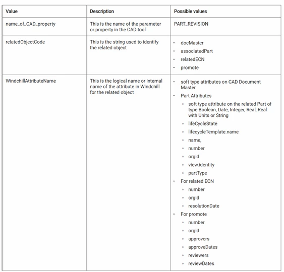

Use Case: Document publication information (Promotion Date, Resolution Datee and Approvers) comes from windchill processes (PR ve CN) needs written to the drawing when the processes (Promotion Request and Change Notice) is completed.
Description:
We want to add the promotion date and the person who approved to our Creo drawing. We want this information to be written on the drawing template when the PR approved and document is released. Similarly, when the change process is started on this document, we want to see the resolution date on the drawing.
I have seen cases for the promotion date. Although we managed to include it for the first publication, we could not write the resolution date and the user name who approved the change to the drawing as a result of the change notification.
We used the following for promotion
promote.approvers and promote.promotionDate. Which fields should we use for the publication process and update the CN process.

Hi @SA_8580177
The help describes the values that should be used for change notice. ECN
relatedECN.resolutionDate
Customizing the Parameters in the Download Service

Yes I want to overwrite Resolutiondate on PromotionDate when the change notice was resolved.
