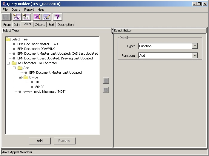

Hello Gurus,
Through query builder, I am trying to add 10 seconds to a timestamp. I have attempted this with the query below but the results are not correct. Can anyone tell me what I am doing wrong?
[cid:image001.png@01CAB47E.375ED040]
Thanks for your help,

Unfortunately, I am still looking for the answer. In the report screenshot, I was just trying to display the value. My goal however is to use this manipulated value in the criteria similar to below.
If (Drawing.lastUpdated + 10 Seconds) < CAD.lastUpdated then include row.
I appreciate any help you can provide.
