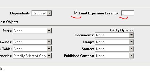

Here is the answer:
In the "Add to Workspace" window there is a box next to which it says "Limit Expansion Level to". If you check the box on the left of it and type 1 into the box on right of it. You will only have the first level of subassemblies under the topl level downloaded into your workspace. Assuming that you have a simplified rep of the top level assembly that excludes everything, open that rep of the top level assembly. And expand the subassemblies. Then you can include whichever second level subassembly inside those subassemblies you want by right clicking >Rep>Master Rep. Once select to include a second level, it will start to download it into your workspace.expand.JPG

Here is the answer:
